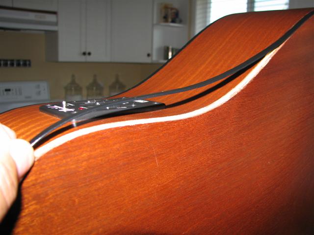

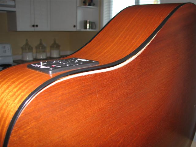

Hey folks, I need a bit of help/confirmation of what I think (I hold that loosely) I know.
A friend of mine has a Guild Dreadnought which has some of the binding pulling off. The binding is plastic (ABS I suspect) and I was just going to use some medium viscosity CA and tape it down. Or should I tape it, than wick in thin CA (this is how I do my wood bindings on my guitars).
I've never worked with ABS/plastic bindings before so I don't know what the best glue to use is.
Any help would be great.
Here are a couple of pictures of the problem.

The real issue is the finish.   If it's polyester, then you could use superglue and clean off any excess with superglue solvent. If it's nitro, then you might want to consider using a good white glue like the LMI stuff. The white glue won't bite into the binding really well, but if the binding hasn't shrunk too much, it will hold and you can clean the excess off easily with a paper towel and hot water or De Glue Goo.

I guess that's the tricky part with a factory guitar hey? What is the finish on it. What can I do to figure out what type of finish is on it?

Whoa guys! Titebond makes a glue specifically for plastic and melamines to adhere to other substrates. Also, another brand called Roo glue works just as well. Water based and compatible with any finish and very easy cleanup. Extremely close to properties of lmi white.

Reading through the other threads Kirk started about 2-4 weeks back, the guitar in my hands is nearly the same as his.
This is not a high end guitar by any means. It's very very heavy, plastic nut, saddle and bridge pins and it already looks like it needs a neck reset (not worth it I'm sure). The saddle is very very low (3/32" above the bridge at the most) and the action is still a bit high.
I guess I'll get me some of that Roo glue (where do you get it Dean) and give it a go.

Roo Glue is often found at supply stores for cabinet makers. I Believe it is
a polyvinyl alcohol, as opposed to polyvinyl acetate that we
normally refer to as PVA. It's made specifically for bonding porous to non
porous surfaces. Short to moderate working time, no interaction with
finishes, cleans up with water when wet, or alcohol when dry. I buy it at a
cabinetmakers supply house about 30 miles from my shop, but I'm sure it
can be found online. I started using it for bindings years ago by
recommendation of Steve at Collings if my memory serves me correctly.
The down side is that it is not friendly to contaminated surfaces. If the
surface of the binding slot is filled with a previous glue, you could be
trying to essentially bond two non-porous surfaces, for which it does not
work terribly well in my experience. You could try to scrape it clean, but
that runs a bigger risk of cosmetic problems (finish chipping) than I think
CA glues likely would. Collagen glues like hide, rabbit and fish can be
excellent for porous to non-porous as well (fish glue is commonly used
for metals or glass to wood) but they again need at least one porous
surface.
Joining two non-porous surfaces leaves you pretty much with CA glues
or epoxies. If it were a synthetic gloss finish I would likely use a CA, as
even if it did stick it would be easy to sand and buff out (Nitro you have
to be much more selective using CA because will really eat in to it). With
the satin finish it looks like you have however, it can be tougher to clean
up and keep it looking satin.
So I say, if the binding has wood fibers stuck to it I would probably use a
natural collagen glue. If it's clean and the wood slot looks smooth and
plastic-like then I might try to carefully clean it up with some stiff 180
sandpaper (being careful not to roll the edges) and use a polyvinyl
alcohol. If you decide to use CA you can minimize finish damage to a
point by waxing the surfaces around the glue joint, being very careful not
to get any in the joint itself. You could also try a water based liquid
masking paint to protect from CA. 3M makes some that will peel of any
finish I've ever seen, but I would be concerned about lower viscosity CA's
wicking in underneath it.

Stay away from it with superglue unless you're well experienced with the combo of nitro and superglue. And I guess there's only one way to get experienced and that's to do some repair and then say, "Oh, F..k!

So Rick, the finish is lacquer? I'm going to stay away from the CA, try the Roo glue and see how it turns out.

I have also glued down Guild bindings (with CA) that were lifting at the waist, the problem seems very common. As has been mentioned, the big problem is if the binding has shrunk too much to fit and the glue line will be large. I have not done this procedure myself, but I have seen recommendations to wipe plastic bindings with acetone immediately before gluing with Titebond, it supposedly makes it easier for the glue to adhere to the plastic. I don't know if this is practical in this situation though.

Rod, does the binding lay flush to the sides when you put gentle pressure on it or do you really have to push it in with a bit of force to get it in place?

I had good luck with the LMI FCA glue. You have to try not to have any squeeze out. Where I did, it was tough getting cleaned up without messing up the finish. I ended up having to touchup a couple places.
The owner has it back now, so I can't show any pictures. The binding shunk and pulled up at the waist, so I pulled the rest of it loose up to the heel and reglued the whole thing. Tiny gap at the heel now.
I also replaced the heel cap that fell off and was lost. I reglued the bridge, which was pulling loose with hide glue and replaced the plastic saddle with bone. The plastic saddle was about .020" to thin for the slot so it was leaning about 30 degrees.

If the binding is actually shrunken (which doesn't appear to be the case in
your photos) it can be re-stretched, but it's a rather delicate procedure.
There is about a 3 degree Celsius gap between the point binding starts to
soften and when nitro lacquer starts to darken and bubble. I have it
written down on my heat gun, but if I remember right the working range
is 81-84. Higher than 83 gets risky. A good variable temp heat gun like a
Makita can hold this temperature fairly accurately, so long as you
maintain a steady distance with an appropriate nozzle. Then if the
binding is heated even slightly unevenly it will not stretch smoothly, and
you'll end up with distinct thin spots.
It's a tricky process that takes some practice on scrap guitars, but comes
in very handy on occasion. For many cases, splicing in a new piece can
give better results after extensive touchup. For a slight shrinkage at a
waist or cutaway, or trying to stretch Guild or Gibson fretboard binding so
that the nibs match back up with the fret ends, it can be a very handy
technique.
